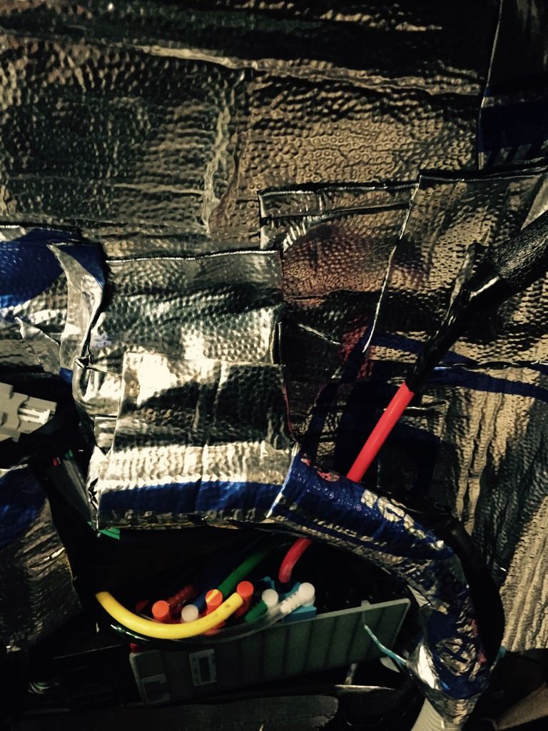

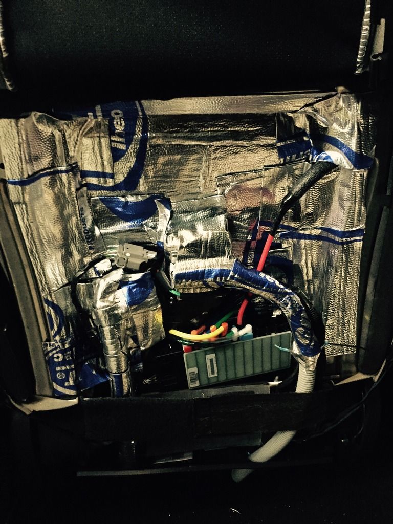

here are a couple of shots...i didnt do a step by step as i was winging it...if your 1/2 way mechanically inclined this is Hot Rodding 101 and you'll see as you go...
I insulated everything that looked like it needed it...you can feel the hot air blowing out of tube and if you wet your finger and put it over the intake you can feel it get cool from air pulling by it...it works good...the seat back does not get as frosty as the seat bottom but its not getting hot and between them both its comfortable...you can get the insulation from Summit or Jegs...its pretty sticky and solid once its in there and the seats moving around so it should be good for the long run
Nice work!

I appreciate the effort you've put into this, sincerely. I just hope ford does something. Soon. Gets old when you can feel your back actually getting *warmer* when the A/C seat is on full blast.

Nice!!!!! That's what we need.
