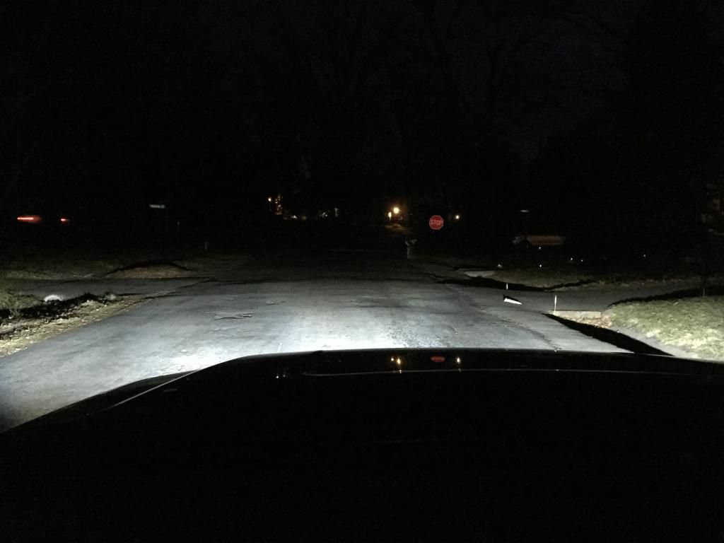

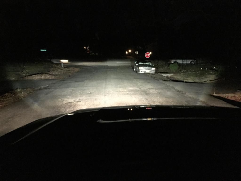

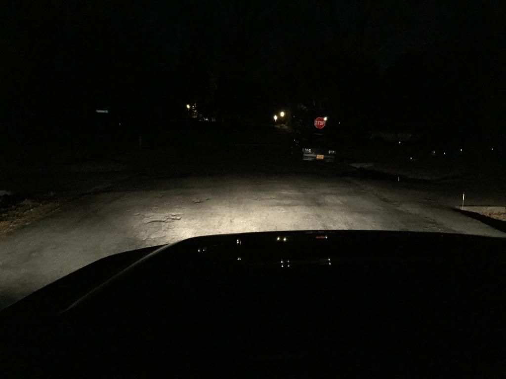

As promised, here are output shots of the stock halogen (9145 Philips bulb) fog lights and then the DOT Duallys.
Stock fogs and HIDs:
Stock fogs only:
DOT Duallys and stock HIDs:
DOT Duallys only:
So the two shots were taken back to back nights, and it looks like I was about 20' further back tonight with the Duallys. I'm amazed at how wide the Duallys throw light...claimed to be a 45 degree beam. I clocked them outward quite a bit so that the overlap in front of the truck was minimal. The distribution is great and bright! The cutoff is well defined and I have them aimed to stay well below the HIDs. The light up the ditches really well, much better than I was expecting actually. Sadly, my HIDs now look more yellow than white. Gonna be a while til I correct that though, as I just sold my retrofit for financial reasons.
