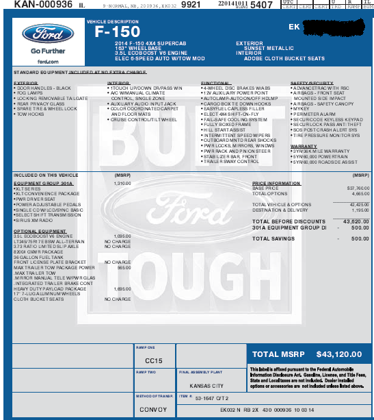

Just for my own knowledge. Weren't the HD payloads only available in lower level models and non SCREW cabs? When I was shopping I only found ones that were XLT's with regular or extended cabs.
You can get HDPP up to lariat trim but you cannot add the 501A or 502A packages. XLT you could add 301A but I dont think 302A. You could get it in a RC 8' bed, Supercab 8' bed and Supercrew 6.5' bed. Most of the ones I have seen are the supercabs but I have seen 1 or 2 supercrew 2011-2014 trucks with HDPP. The 2016+ HDPP trucks are much harder to identify since they no longer have the 7 lug wheels.
