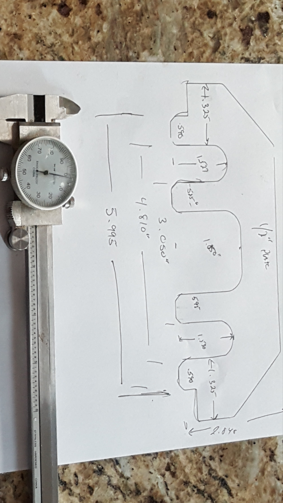

I had that same thought, even measured the holders @ the dealer.
Yes that looks pretty good. I bought the tools and the secondary timing chain guide hold down pin. I didn't like the fit so I scanned it into our system, and machined a few sets. It locks and holds them much better now. Specifically when torquing the phaser bolts during the final torque to yield.
I found it easier to just use a wrench on the cam flats when doing the final toruqe. But we also had 2 people working on it so the extra set of hands helped a lot.
