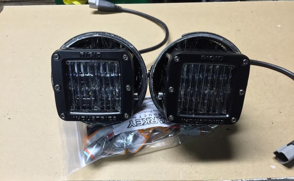

I cannot take all the credit. The general idea was mentioned by a member on another forum. I googled the living crap out of Ridig, Dually, Fog light, etc and never found anything other than people bolting them directly to the bumper mounted bucket; nothing into a light housing. Figured I'd give it the old college try and I'm pleasantly surprised. I'm actually most shocked at how little they move once mounted. I didn't put a washer between the nut and the Rigid mount and they've yet to move.

Why did you wish to avoid mounting straight to the bumper?
Discussion starter · #47 ·
Doing it this way retained the ability to use the stock adjustment screw. The beam is so well defined that the need to aim them is high. Trying to adjust the height once mounted directly to the bumper or the bucket would be damn near impossible since the Rigid bolts are on the sides of the Dually. Aiming them is just as crucial as aiming the headlights. Just takes a turn of a screw to align them now.

I drilled out the side of the bucket so I can still get an Allen wrench in to adjust them.

I thought about that but that was more holes that I didn't want to create. The nice thing is that I can put the stock halogen housings back in within 20 minutes and nothing looks different. To each their own though...I like the outcome even if it was a bit of work.
