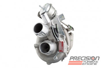

I don't care what you run, and am not some lead authority in EB turbo upgrades, but these are what I was recently looking at. These are OEM turbo's that have been remanned by Precision. I don't know whether or not they're better than other turbo upgrades, but I do know that Precision has a reputation as probably the most efficient turbochargers on the market.
