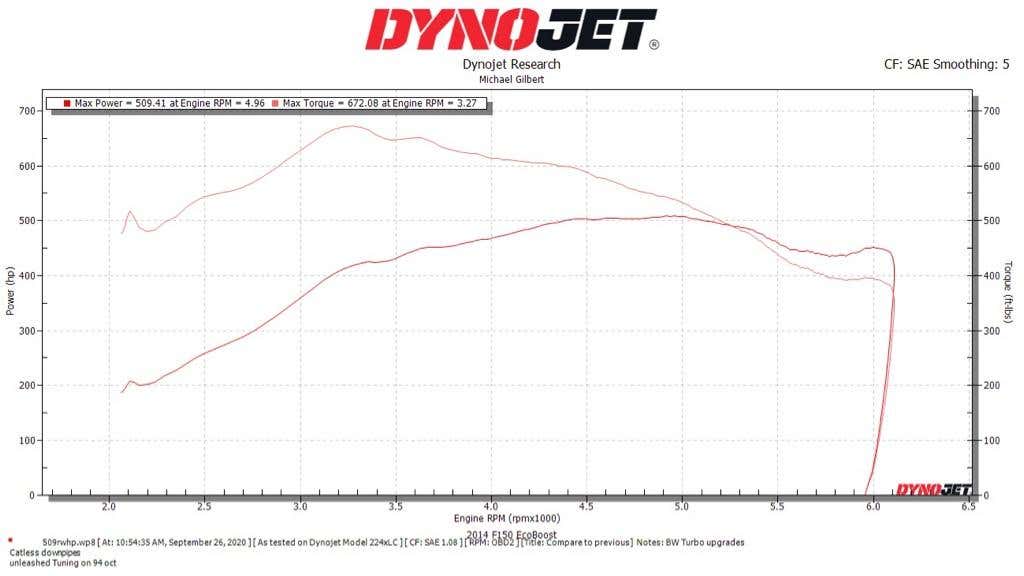

2014 f150 limited
Unleashed tuned
509rwhp
672rwtrq
Performance Mods
-Tuned by Torrie @ Unleashed tuning on 93/94 octane @tmcphail ;
-Gen2 raptor catless 3” true dual downpipes
-Borg warner efr factory location turbo upgrades
-AMS turbo adapters
-Ported oem manifols
-sp-542 spark plugs 0.026gap
Reliability/consistency
-full race front mount intercooler
-full race hot side pipe
-full race boost pipe
-full race throttle body spacer
-MSD coils
-JD In tank fuel system with a walbro 535 pump
-3 bar map sensor
-Snow performance progressive stage 2.5 meth injection (70/30 mix) with 2.5 gallon tank, on its own dedicated and fused circuit, spraying in the full race boost tube about halfway between the tb and intercooler, wanted more cooling
-exedy stage 2 clutch kit with hardened steels and snaps
-rat stat 170 degree thermostat
-tial/full race 50mm blow off valve
-Afe stage 2 intake because i like induction noise
-Rx big catch can with the clean side separator
-Vas trac bars
-2300’ elevation
-truck weight with driver 6306lbs, tailgate, tonneau cover, bed mat, spare tire and jack tool kit removed,
At 4000', that's plain wicked!
That's impressive torque numbers. Hitting hard at ~2700rpms.

Thanks. Just gotta get the water meth dialed in a bit more up top. Where im using it for cooling i think ill have to dial it back 20-30% to get rid of that dip when it’s around 15 degrees celsius outside or below. Saturdays dyno day i dialed it back a bit and it started to get rid of that dip at the end and flatten out

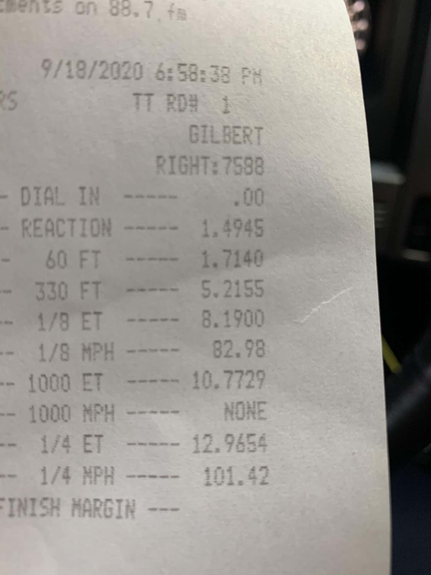

1-4 hit starting at 20mph and letting out just after the shift into 4’th gear
3’rd gear hit 2500-61/6200rpm

the numbers are very good, but the 1/4 mile time is to slow for the hp, and tq.
